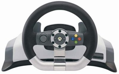

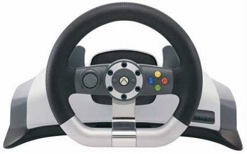

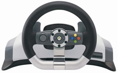

But while I've been super stoked with the precision of the Logitech G25 I bought off a friend (whom some of you know as Whrlwind in IL-2, AlloyCrkr in World of Tanks) when he upgraded to a G27, the G25 only has but two buttons on the wheel:
I'd had four buttons on my old wheel (which was an amazing deal from Target for $20, 15 years ago, but was a POS as far as steering precision--which is the primary function). And AlloyCrkr's new wheel had six buttons on it, so I had a serious case of button envy.
