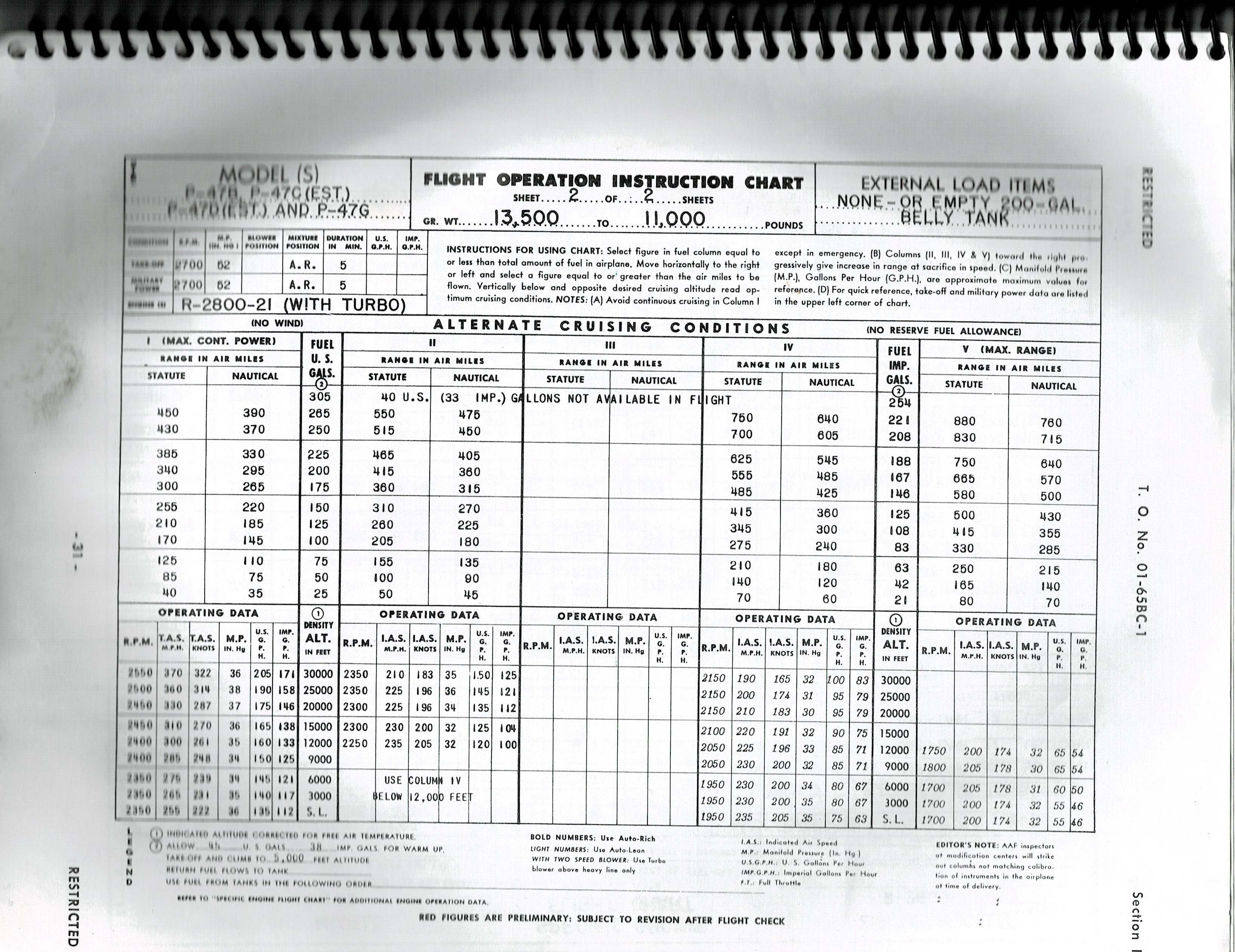

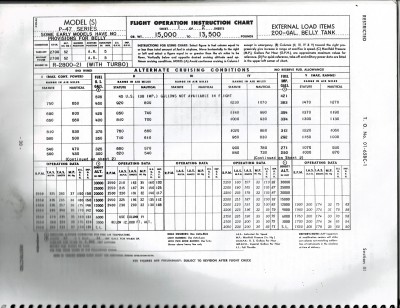

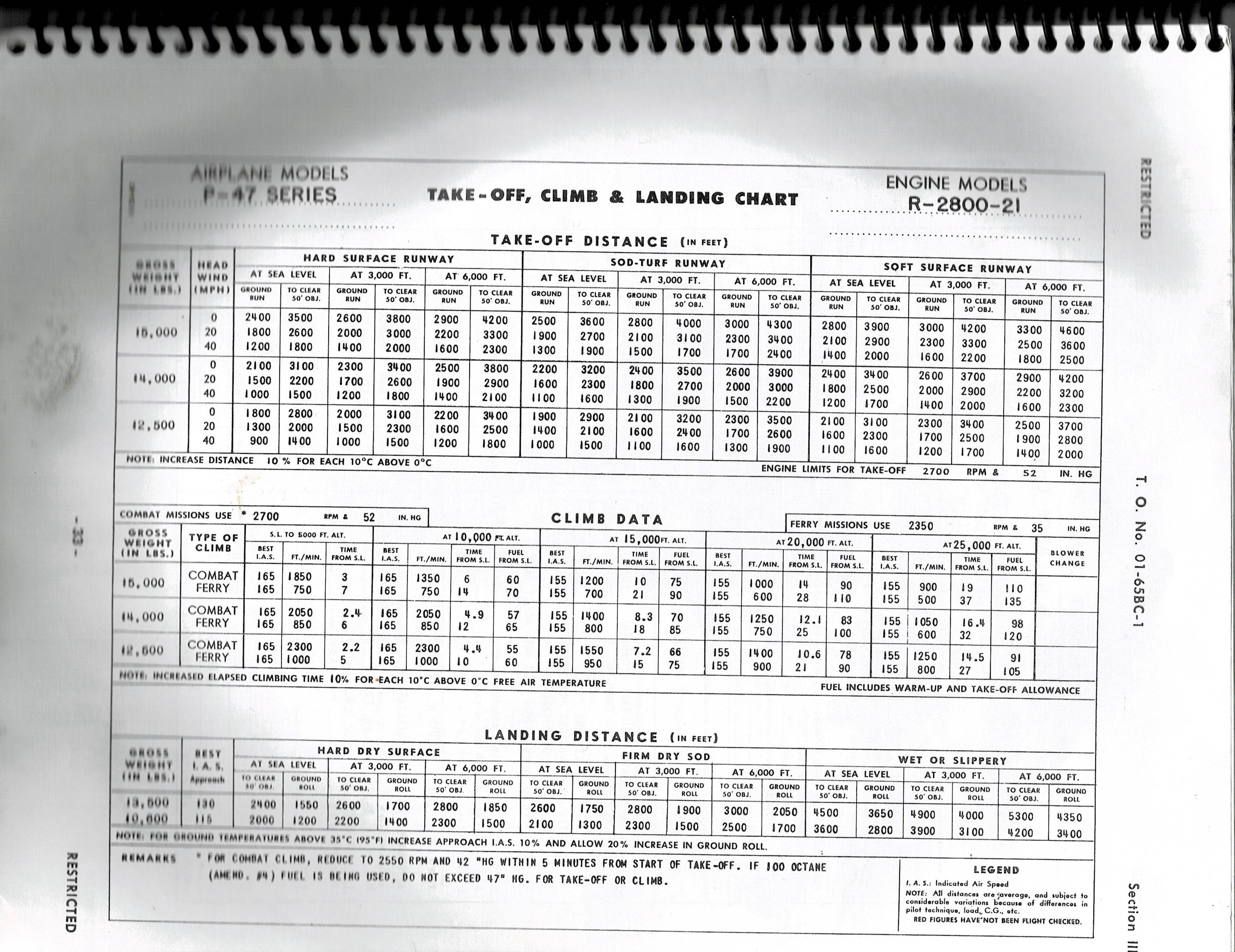

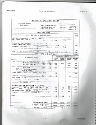

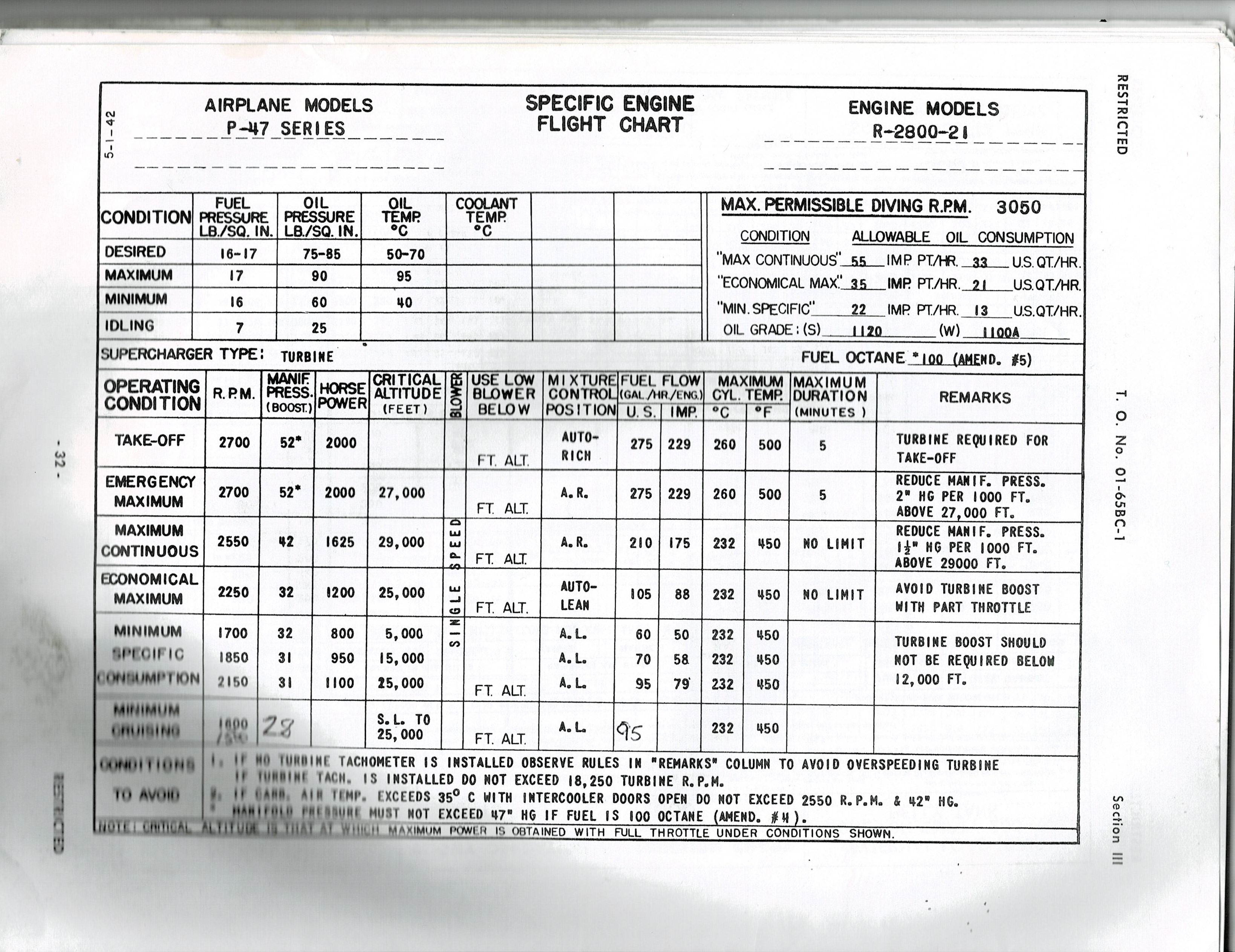

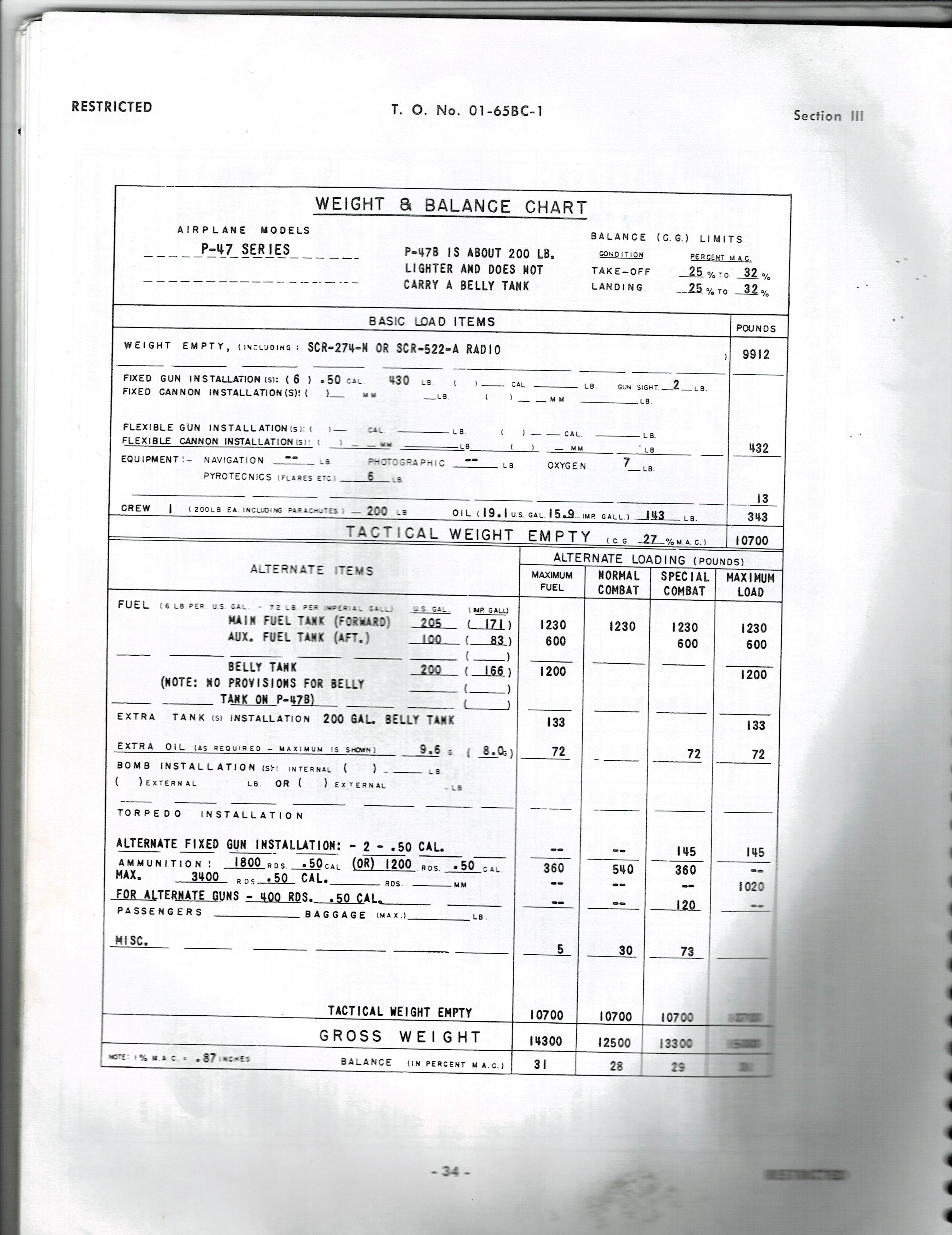

I have an old paper copy of the P47 pilot's manual. (its a little old and has some water damage to it, but...hopefully you can make use of the downloaded images)
If not, let me know, i can scan to pdf and post on our downloads site.

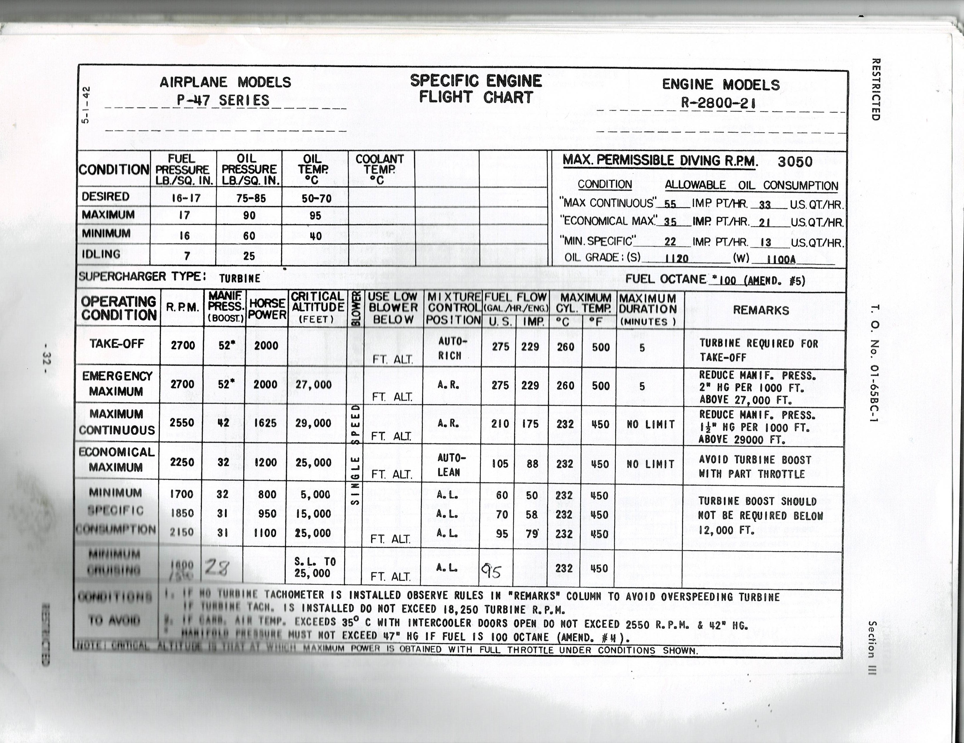

Please see the attached - I've photo copied the key operating parameter, weight and balance, and fuel consumption tables!
So you can plan your combat accordingly, and fly the jug to its limits.
S! Enjoy!
P47 - Pilot's Manual - Operating Tables

Useful... Thank you DaddyO !
