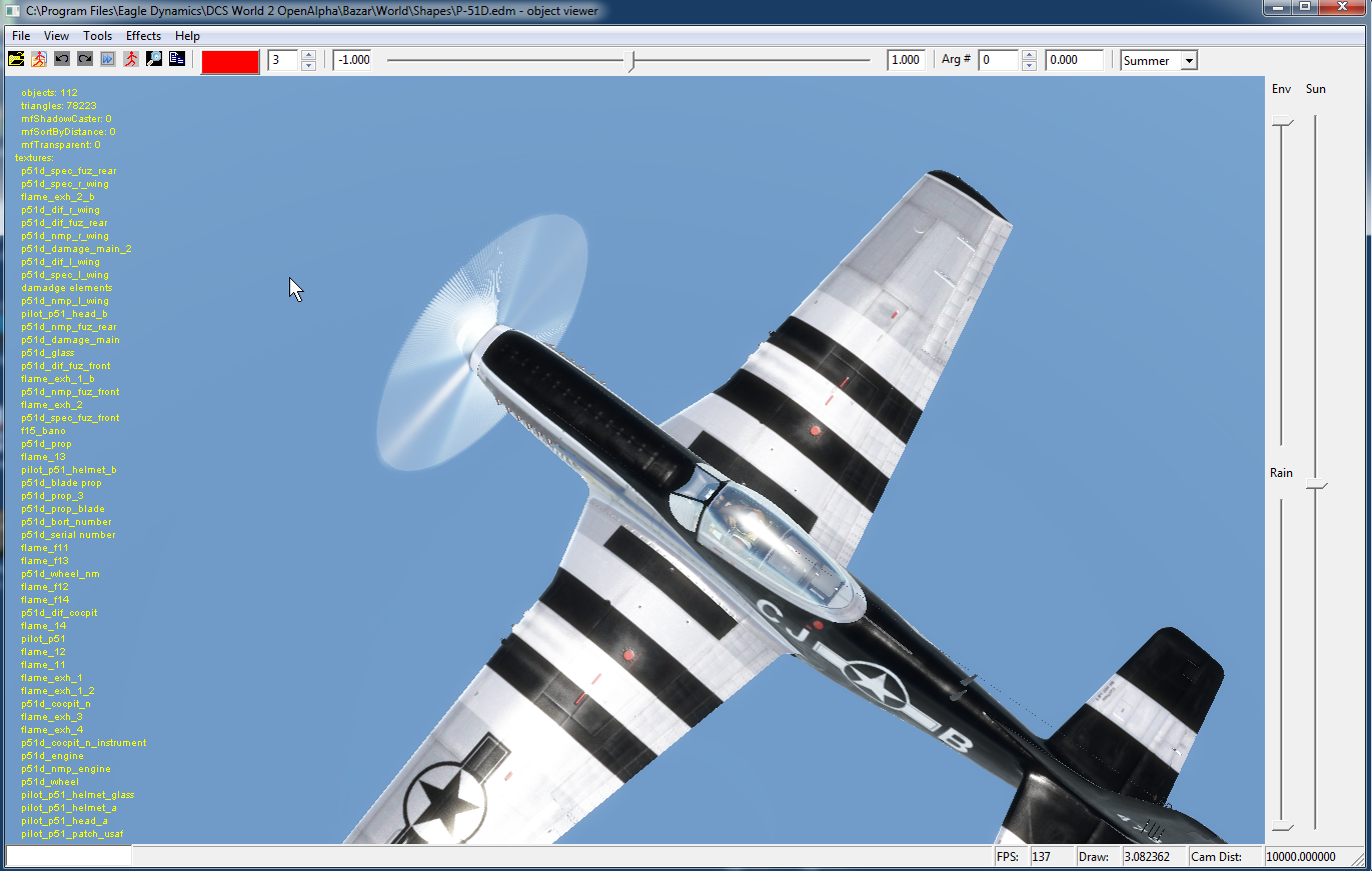

PS - if you want to mess around, look into using the \bin\modelviewer.exe in the \game's bin folder, this is a handy tool for use in viewing and manipulating skins without all the overhead of reloading the game.
PPS- Keep in mind, you may not see skin updates until you stop and start the game, DCS loads the skins files necessary often at startup. So close/open after making changes.
With these simple tweaks your lovely P51D v1.5 skins can look great in v2.0 too!
