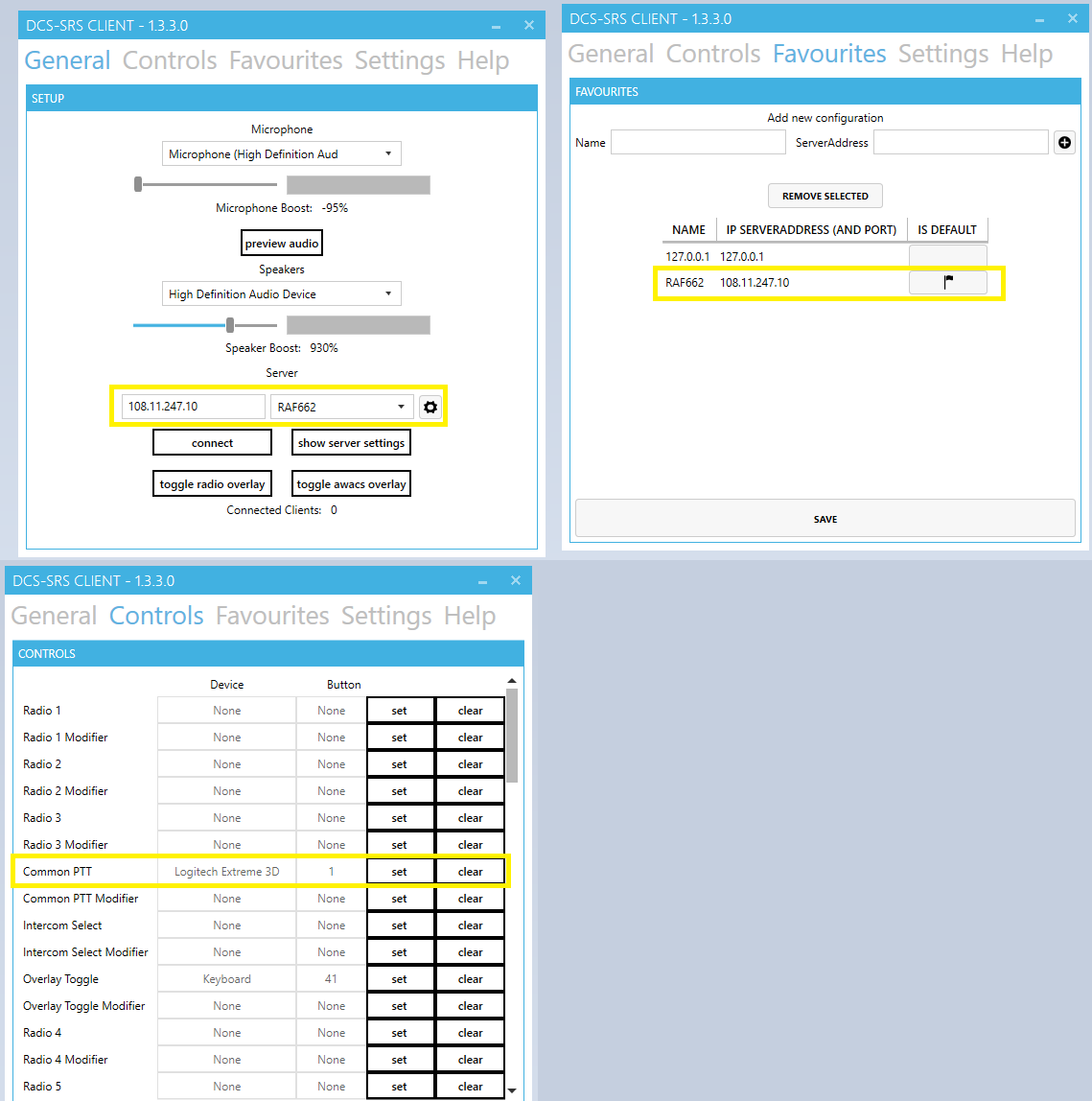

Under controls in SRS I bound a PTT key to my joystick. I left everything else on default.
The 71st have it working but could only hear static from me, trying to figure that out.

S! thanks.. ok i got the client to recognize my game AC radio now! I had mistakenly deleted my export.lua file during the trials to get this going. So now my client and overlay are working when i move between AC.
One Question: is there a PTT key in the spit? What button, lever, or doo-hickey do the spit jockeys jimmy-with in order to make with the gab?
Re: Simple Radio now Running - on RAF662.org WWII server
S! yes there is a PTT in the Spitfire, I bound it to the same key I have in SR. You can see the light change on the bottom of the radio when transmitting.

S! thanks RAV, works great. All we have to map is the PTT (push to talk key) in the SR console as you show. And the rest of the radio functions can be controlled from in-cockpit as normal. Thanks, very simple to setup.
The program will auto connect when you join the server, so you don't have to enter a IP manually.

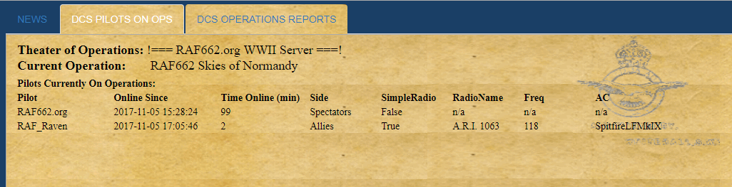

S! guys,
the live operational reports of pilots online on simple radio should be hooked up and working now!
The new DCS PILOTS ON OPS tab should display live online pilots and additional columns indicating whether they are online on simple radio or not.
S! should be hooked up and operational now.
